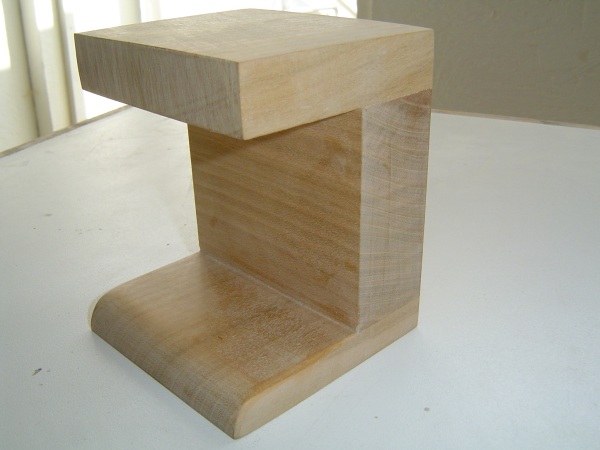

Or do as I do and use a three piece neck block horizontal grain on the centre section and grain running for and aft on the foot and top.
This ones in Cherry.
Colin S38961.6594907407

Colin-How do I use the user uploads?
Mike-you use a laminated block to accept your tenon on your neck? I think I understand the advantages of the laminations.I'm going to have to investigate this further. Clinton

Colins block is perfect!
I'am going to a bolt on system -BUT with a laminated block for strength .

Hey, when I refreshed the page the image came through. I like that! I appreciate the wisdom on the end grains. Ain't this place cool. Clinton
PostPosted: Fri Sep 01, 2006 8:42 am
Michael, This is block is also for a fully bolt on neck, so a channel will get routed in the top section for the neck extension to fit. The neck is also in cherry, I like to use the same wood in the neck block as in the neck as I feel that when bolted up they become a single unit.
I've used this style on about a dozen guitars or so.

[QUOTE=Colin S] Or do as I do and use a three piece neck block horizontal grain on the centre section and grain running for and aft on the foot and top.
Colin - It looks like you have long- and short-grain surfaces glued together. Do you ever have any problems with this with changes in humidity?
If you did have a change in moisture content in the wood (for example an increase in moisture content) , the top and bottom pieces would expand laterally, and the center piece would not. It seems to me that you would either get creep in the glueline, or failure of the glue joint.
In the top and back of a guitar this situation exists also ( at either end) , but in that case the top and back are thin enough to allow some deformation (in the same way that plywood is glued together long- to short-grain and survives). Here, the pieces look very solid.
Obviously this works for you, but I'm surprised you don't run into problems.
Phil

[QUOTE=Phil Marino] Colin - It looks like you have long- and short-grain surfaces glued together. Do you ever have any problems with this with changes in humidity?
Phil
Phil,
What would be your estimation of the integrity of the glue joint over time if the top and bottom piece in the assembly were flat sawn? I'm asking because I use the same neck block design as Colin. Joe Beaver38962.6271527778

Phil, never been a problem, these are relatively thick pieces of wood so any change in their moisture content is very slow. I've made 25 or so with this format, and not a problem in any one. I know quite a number of builders who do this and have never heard of a failure.
If you move it from winter Canada to summer Florida there might be a problem, but you'd have all the braces pop of long before this joint gives a problem.

[QUOTE=Joe Beaver] [QUOTE=Phil Marino] Colin - It looks like you have long- and short-grain surfaces glued together. Do you ever have any problems with this with changes in humidity?
Phil
Phil,
What would be your estimation of the integrity of the glue joint over time if the top and bottom piece in the assembly were flat sawn? I'm asking because I use the same neck block design as Colin. [/QUOTE]
Joe-
Most woods expand and contract 1 1/2 to twice as much (with changing moisture content) parallel to the growth rings (flatsawn) than right angle to the rings (quartersawn).
That's one of the reasons tops and backs are usually quartersawn - for dimensional stability. The mechanical properties (stiffness and strength) are pretty much the same either way.
So, the more stable quartersawn orientation - for the top and bottom pieces of this glued-up neck block - would result in less glue line (and wood) stress if there were a change in moisture content, compared to flatsawn top and bottom pieces.
But, as Colin said, if there's not much humidity change, it won't be a problem either way.
